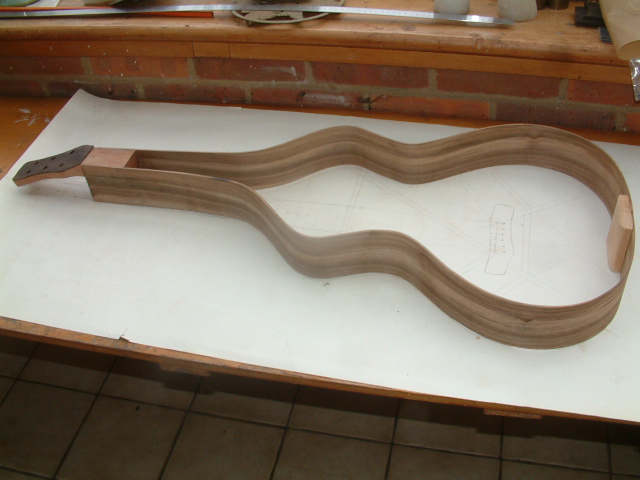

Here's the latest creation taking shape. A first for me as it's a Weissenborn type acoustic lap-slide. As a prototype, I'm trying to make it as much as possible from odd pieces of wood I have had around the workshop for a while. So it will have English walnut sides with Sapele top and back. The top and back will each be 4 piece.
Here's the rim set with peghead attached - a totally new experience in neck building for me:

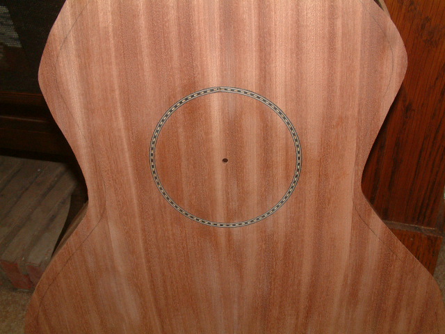

The top rough cut with rosette installed:
A closer view of the rosette:

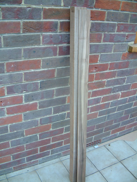

David - I made my own plans, based around the dimensions I found in the Acoustic Guitar article on Weissenborns. The bracing etc won't be "traditional" as I'm trying to see how my methods translate to this insrument. The top and back will be domed to my usual degree and the back for example will have a double X brace.
Colin - No. I bought some walnut pieces from Isaac Lord here in High Wycombe a few years back including a long 3"x3" piece that I thought would be useful for necks and binding. It's perfect for Weissenborn sides:
